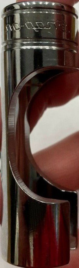

I have always used a standard 5/8 or 16mm wrench, never had any problems with rounding anything?
me either but i do have line wrenches and such for tractors and other equipment just hadnt' needed the crows foot before, Harbor freight and they were fairly cheap, like 14$ for a set of 7 SAE
12,464
11,228
You could. You could also try cutting a socket down first. If that works, it would save you some time.

I picked up a 5/8" Impact socket I was thinkin of going to cut down to make one for the IP couple years back.
Iam a long term thinker I guess. This is getting me motivated to start grinding on it to see how bad I can screw it up. LOL
