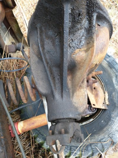

My guess is this is the Dana 50 I don't know

And then this would be the Dana 60 with that smooth slope and no hump on the front the way I understand it

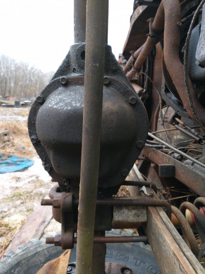

do they make a dana 50 for the front Axel ? I found a 60 and a 44

OK well it turns out that is a Dana 44 front Axel.
Just don't know if Dana 44 is big enough for this one ton from what I've read for street use it would be just fine.
I will need to find the coil spring supports for the bottom of the coils.

Does the front axle have 8 lugs or 5?
It is 8 lugs but has the smaller pan I understand that makes it a 44 thank you
Thanks for the reply guys, I am not going to change the axle for the now would really like to have the 60 in there when I do.

Maybe this will help. The difference seems to be outer end wheel hub diameter.
