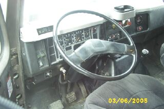

Here's a pic of my pyro/boost gauge in my 4800. The picture isn't close-up enough. It's over to the right closer to the passenger side:

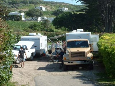

The day after I got back from my work trip I went camping at the beach for a few days with the family.

Will it fit in my cluster, my gauges seem to be square but that could just be the window?

Dude!!! Your truck must really turn heads at camp sites!!
The gauge would have to be drilled into your dash. It won't fit in the square stock openings.
I'm almost positive it goes in an International "Eagle". That's one of their big OTR tractors.
It's an easy install. Just get a 2 or 2&1/8" hole saw and have at it. Hook up for a pryo is so easy on our trucks.

The comments at campgrounds are usually "sure you have enough truck for that trailer?"
Nevrenufhp and I were looking at my turbo and exhaust mani for a place to drill for the pyro probe and my options seemed to be limited. The non oem gauges have a more detailed face and probably better illumination. I was trying to think of a spot were I could have the gauge facing up slightly.

It's easy, just drill right into the mani. between the ********* tapered intake pipe and the turbo. Anywhere along the mani. works, but I wanted mine centered. :thumbsup: It'll read a little high since it's basically probed right off one of the cylinders, so it'll be a tad lower in the turbo itself.
Mount the pyro gauge in the sheetmetal over to the right of your heater controls. Should have room there.
