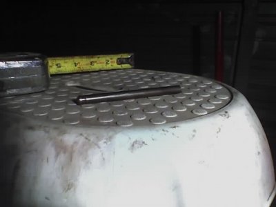

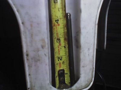

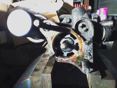

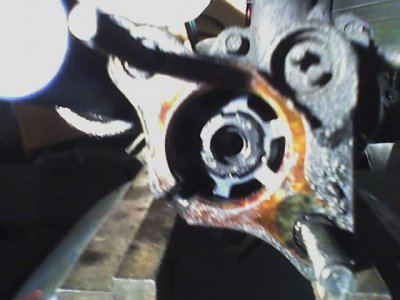

I finally found my way over to the corner where the last hydro core is residing. the "pushrod" is held into the unit by a plastic clip that breaks when pulled hard enough:eek: Oh well, it needed rebuilding anyway:D
Ok....time to fire up the mill....
overall length is 4.25"
dia is slightly less than the guide on the hydro, so use a drill index to find it.
both ends are rounded. One end has a groove cut into it for the plastic retainer.
lookie at the pics.....
