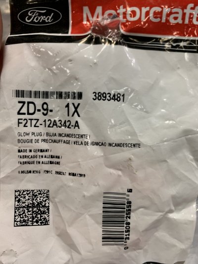

I picked up some motorcraft glow plugs today. They are zd9-1x. They didn’t have any references to the zd9-iirc. They look the same. These were made in Germany. The ones I pulled out were made in Italy. Doubt that it matters. Has anyone else used the 1x version?
