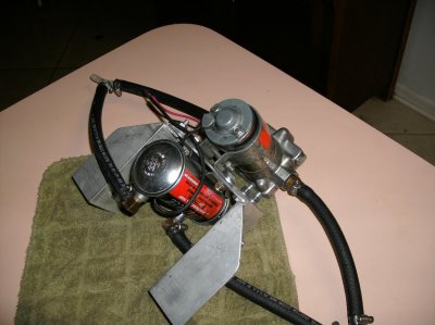

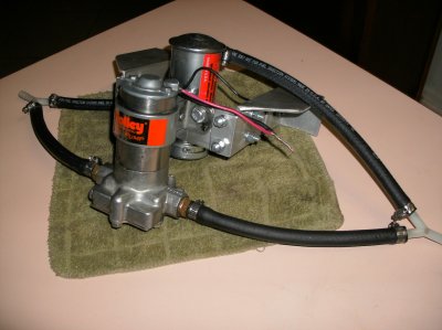

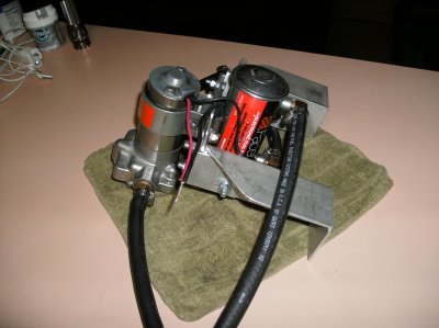

Yeah, I feel your pain... That's why I made this- I get a solid 6psi post filter now. Sounds funny though, the Holley goes errrrrrrrrrrrrrrrr, and the Facet goes bbbbbbbbbbbbbbbb. A couple Powerstroke guys got out of their truck and were walking past my truck at Home Depot when I switched on, they both looked around and I overheard one of them remark "Somebody's fuel pump works.." I just thought to myself, yessir it sure as hell does..LOL
