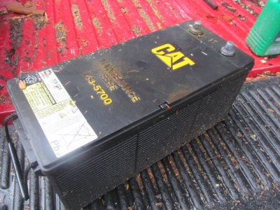

Im thinking of removing/relocating my washer reservoir, drivers side battery and coolant overflow tank and installing this puppy in its place.
19'' long and 9'' deep. 1125 CCA. I would remove the passenger side battery also and put the washer and coolant tanks in its place im thinking.
