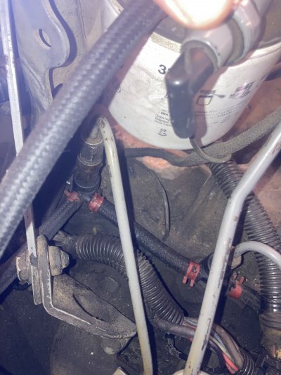

Okay I assumed that since the fuel return goes back to the filter and back to the tank there could be air in the lines from the return side.
To be clear the roughness upon startup is greater the longer the truck has sat. For example, if it sits 6 hours and gets cold (I assume it is getting cold when it is 20 or so outside and it is sitting outside for 6 hours), it'll rattle a little. If it sits 24 hrs it'll rattle like it is falling apart. If it sits an hour or so, or maybe even a couple hours, I will have absolutely no rattle and it runs fine.
How you describe it is why I agree with @IDIBRONCO that it sounds like your supply side fuel is falling back due to air intrusion. I know I’m repeating what was said but your supply side should be under slight vacuum so if you have air intrusion somewhere like in the filter head or components it’s going to let air in and go backwards. Then when you start it you are pulling air + fuel until it clears.

I’ll try to keep it high level to not trigger a big debate on whether the return system can cause air intrusion but there is suppose to be check valves on the filter return port I mentioned and the IP return port. That’s why the scenario that I said could potentially happen shouldn’t happen in theory. Also we will put really worn injectors aside.
I’d be testing with the filter head first. When it sits and you think it has air have someone crank it while depressing the shrader and see if you have air in the filters. The fuel heater o ring is common intrusion point. Trying to keep it easy and common things for you. We can speculate a lot.

Yep you’ll want to fix that and thats what I was sayin before, you aren’t tightening the return cap down that’s not how it works. The cap is pressed over the injector inlet body and your supply steel line shouldn’t be touching it. The o rings are what seals it.
