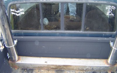

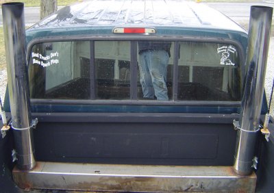

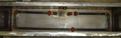

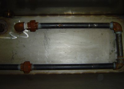

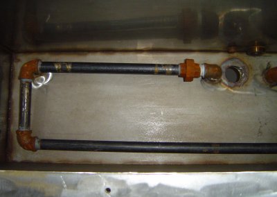

I used sch 40 balck pipe 3/4" as one of my heat exchangers. Then used the SS tank and the SS heat sink for my stack that the tank sits on.
