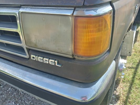

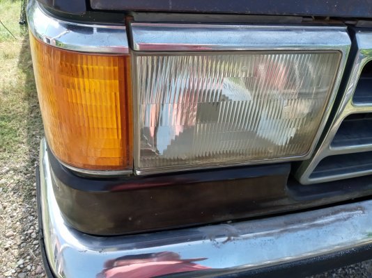

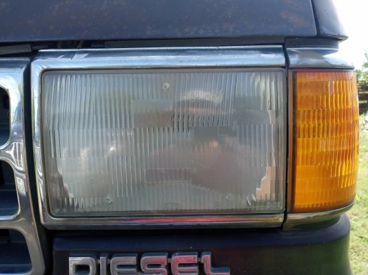

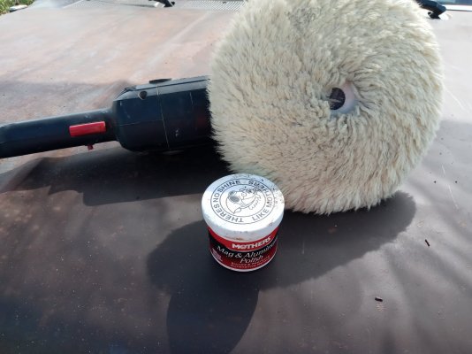

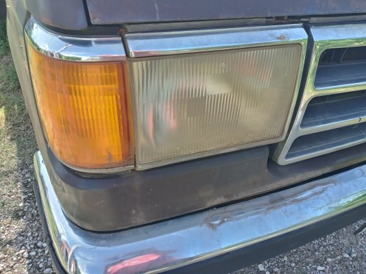

My headlights are all yellowed out. I need to pass safety inspection. I saw a thread earlier about new headlights on Feebay. I would love NEW headlights. But no cash for that right now. I tried in the past on cars with the pricey headlight cleaning kits. Those were all pains, took a long time and $20 each go around because it doesn't last long. Then I saw the other day a Youtube about using Momma's aluminum polish ($5-ish) and a buffer. Just put some on and buff it out. I remembered I had a 2 year old can of it left from doing the lowers on my Harley. Anyway here's what happened.

I saw the same video, and have had amazingly easy and good success on my 2000 Corolla, and two 2005 S40 Volvo's. Admittedly the clear coat was already off these vehicles, so I can't say anything for clear coat. Ended up getting new lenses on my pickup before I knew about this trick, but the 3M kit didn't do anything to the clearcoat when I tried that before I replaced them.

I have been using Blue-Magic metal polish for years the same way. If you happen to have your instrument cluster out, before you put it back in polish the lense with this stuff, it will look like new. And it does work well on metal and painted surfaces too. If you let it sit around a long time it will seperate, but all you have to do is stir it back up before you use it.

The mothers aluminum polish is a very light metal polish because of how soft aluminum is. I have polished several set of plastic lenses including the ones on my 1990 f250. I use with great success the turtle wax heavy duty rubbing compound followed by the polishing compound, and they come out very good. if you want better than that hit them with some wet sand paper (600 then 800 and then 1200 grit) and then spray with several coats of clear coat and then polish the clear.
