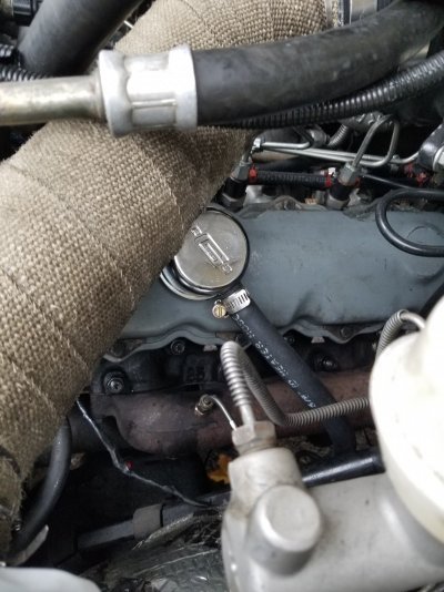

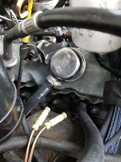

Draft tubes, and I still have a gutted cdr valve, hooked up to a banks system.

Yea the belt that takes oil for a ride. This some old filter and a 1in 90 coulpler, I have someone weld together. This give ideal of the space arond, a -16 off a 90* could work.
That filter did get moved up...
