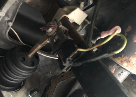

Here’s the component. There’s some electrical tape but it’s just covering some stripped section of wire - I don’t believe this is a cause at the moment

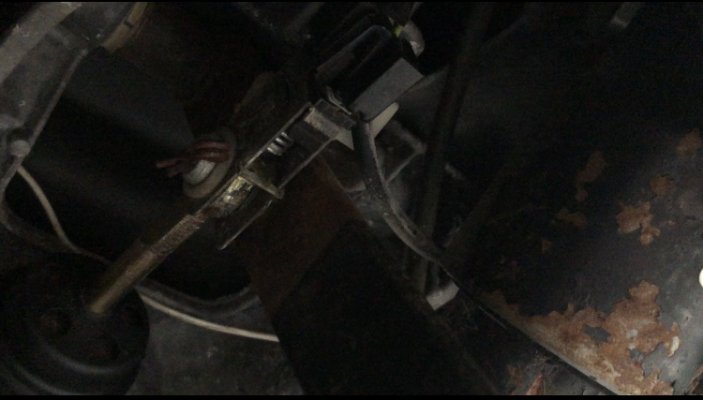

Haha think it’s all good now. It was a while ago but must’ve been after replacing the brake booster. The sensor was installed incorrectly - it needs to be perpendicular to the pedal not parallel
Correct that is how it should sit.
