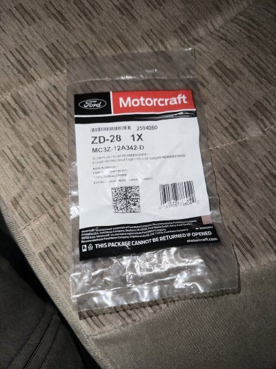

6.9 can use zd1. The zd28 is used in Kubotas. They also don’t look like they’re getting that hot. A lot of buildup on tip that heats.

Well, I say that because you know how sometimes with ford there's the "left over parts" that can get used up at the beginning of production.
Interesting you say that i asked for zd1 they said this is same just a superceeded number. They came in motorcraft wrapper.
Confused now

For some reason I got 87 stuck in my brain, and they're selling you the wrong plugs I think. In all the GP threads on here I haven't seen ZD-28, it would have come up.

Thet were bad (open when tested) got new set under warrenty. We will see what the light tells.

My oem supplier shows both part numbers zd1 and now zd28 as interchanging, no other footnotes......but neither plug says anything ZD on it, and both say beru in the first position of the lettering.
Something is fishy with those plugs of yours. And i need to do some research on this new zd28 thing?
