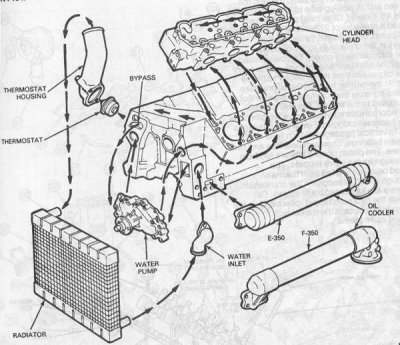

Someone posted a coolant flow diagram a while back that showed the factory overtemp sensor being one of the last places that coolant flows before it gets pumped into the radiator. So it should be about the warmest place in the cooling system.

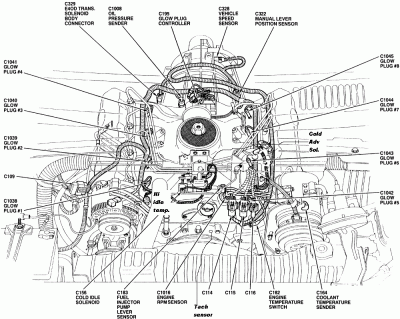

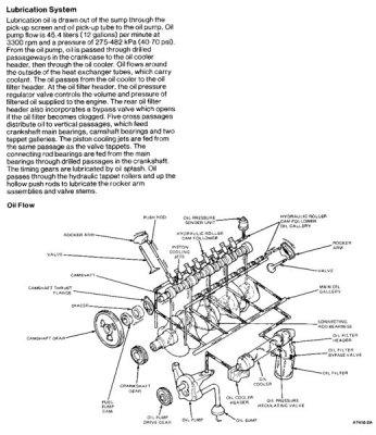

Pretty hard to tell you where to put them, if you don't say what gauges you have. But here is where for various gauges.
COOLANT Temp. You'll have to drain some coolant out. It installs in the front of the block, remove the sensor, the upper one, that takes the place of the over temp idiot light. That's the engine temp switch, not the coolant temp switch.
TRANSMISSION Temp. That sensor goes in the pressure test port, location is just forward of the shift shaft on drivers side.
Oh Shi*t you have a 5 speed. Disregard.
OIL Temp. That sensor, location is drivers side, rear of engine lower ear, there is a pipe plug there.
EGT Temp. Location, drill and tap the exhaust manifold between #6 & #8 cylinders, whatever size sensor it is.
