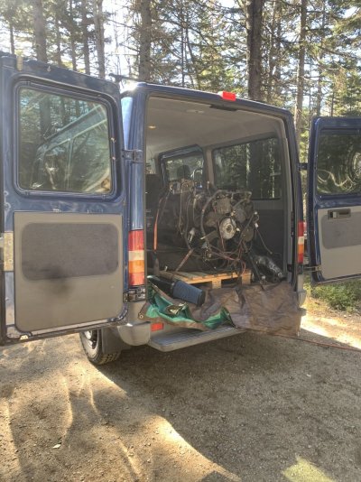

So..after seizing my 7.3 idit I picked one up for $650 bucks and a long drive. I got it home and have it hanging from a chain. I got it running on the chain and it’s puffing on the drivers side manifold..one big white puff when one of the cylinders fire as it idles. Other than that it runs smooth on the chain.
I drained the oil and I pulled the pan. The crankshaft where the two connecting rods mate is discolored on the crank itself..rainbow like over heating...are cranks like this from milling or has this motor been beat up before. It’s got a reman turbo, injection pump and injectors
The tranny that came attached dumped metallic goo out of the rear nothing close to red trans fluid.
I’m really hoping I didn’t just buy a pile of metal..I’ve been changing the gaskets before attempting an engine swap.
I’m having a hard time finding a idit to replace this and I’m getting close to just selling it all. I have little kids and hate to miss out on them for some oily mess. But if it just gets done I’ll keep plugging away.

I'd roll with it. And while you're rolling, put time, energy, and money in the original engine using it as a chance to show your kids what a engine does on the inside. Then swap it back, but that's just how I do things. It's kinda what I'm doing now.

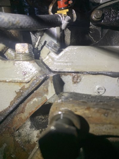

I noticed the rear intake manifold has rtv sticking out...there was a slight leak, after investigating I noticed the bolts were all loose. I’d rather not pull the turbo and injector lines...could I clean it up and squeeze some sealant into the crack in the photo? Maybe it’s not needed after tightening it all up.

I’ll just keep moving forward then. I’ll check out a bearing cap..
That's what I'd do, I mean you're just buying time and you proved that it will run.
