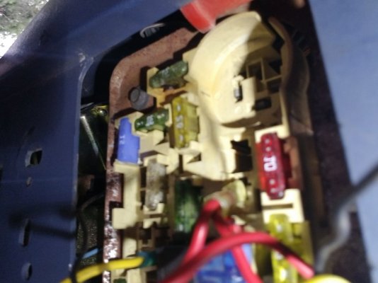

Jan 17, 2024 #1 Kdo58 Full Access Member Joined Sep 8, 2021 Posts 185 Reaction score 194 Location Puyallup washington My fuse has melted in the fuse panel, and it does not want to come out. Attachments 20240117_124926.jpg 190.3 KB · Views: 11
Jan 17, 2024 #2 KansasIDI Hopelessly addicted to IDIs Supporting Member Joined Jan 21, 2023 Posts 1,214 Reaction score 993 Location Wilsey, KS Kdo58 said: My fuse has melted in the fuse panel, and it does not want to come out. Click to expand... I would recommend disconnecting your batteries, and trying to get it out with needle nose pliers and a pick.
Jan 17, 2024 #3 gnathv Full Access Member Joined Oct 18, 2007 Posts 1,051 Reaction score 528 Location Athens, Al Most likely fan motor drawing more than it should.
Jan 17, 2024 #4 Kdo58 Full Access Member Joined Sep 8, 2021 Posts 185 Reaction score 194 Location Puyallup washington I got it out, diagonal plyers, needle nose and a pick, I will have to get a new fan motor.
