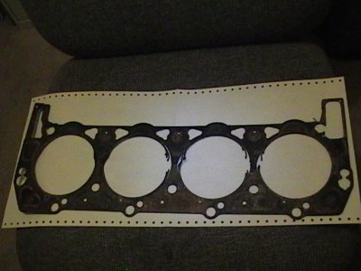

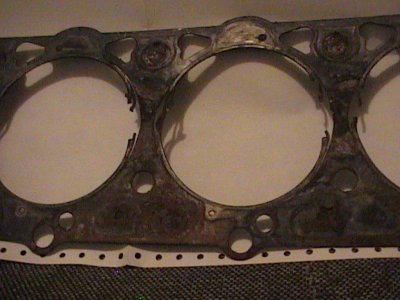

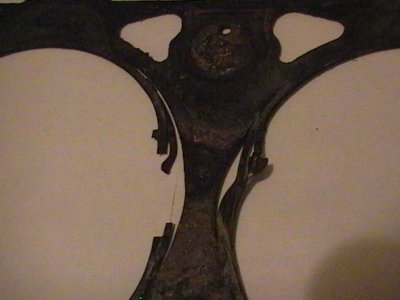

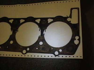

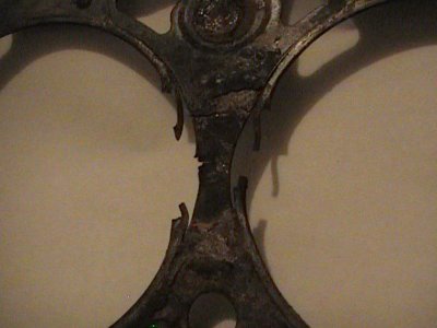

My experience with a 90. Bought it and drove it for a few days. Parked it for a couple of days. Went to start it and wouldn't turn over ( just like you said above) 1/8 turn and bounce back. Removed the GP's on drivers side, tried to start and coolant shot out of #6 and hit my grandson square in the face, he didn't like that at all.
Remove the GP's and roll it over, it's cavitated. That coolant won't go down into the oil pan or very little of it will. Stand back, that coolant will come out with great force.
Here is what the head gaskets looked like from driving it. Pretty Eh. Yes there was holes in the #6 cylinder wall.
New remaned Promar engine for $3200, that was 10 yrs ago.
