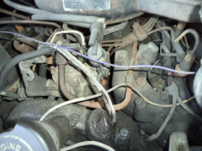

your pics should look like mine, that is the vrv to the right, with the 2 vacuum lines attached. the second pic shows it from the side with the adjustment. you might be better off scouring the junk yard for a vrv and the parts for it to make it work, you might luck out with a good one. if my memory serves me correct when I bought that one new from ford, they didn't give it away, I don't even know if you can still buy them new... maybe aftermarket or trans shop might have them too.

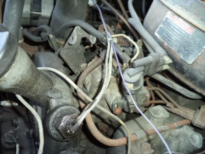

Ok, wait, I have a pic that I took yesterday.
Is that 'cruise control' in the upper right? If so, then it's the black cable at the throttle that is cruise control, not the red one. In either case, no throttle kick-down...

Yep. That's a cruise module.
You don't happen to have an overdrive off switch somewhere down on the dash(your year model) to the right of the steering column I think? Just curious. I don't see the wiring in any of your pictures for the e4od controls on the pump either.

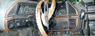

It is a cruise module. But there is nothing inside the cab of the truck that has to do with cruise control. No controls. No levers. No knobs. Nothing anywhere that says anything about cruise. Etc. Absolutely nothing to indicate it has cruise control.

All of the cruise control buttons might have been on the OEM steering wheel and yours looks to be aftermarket.
