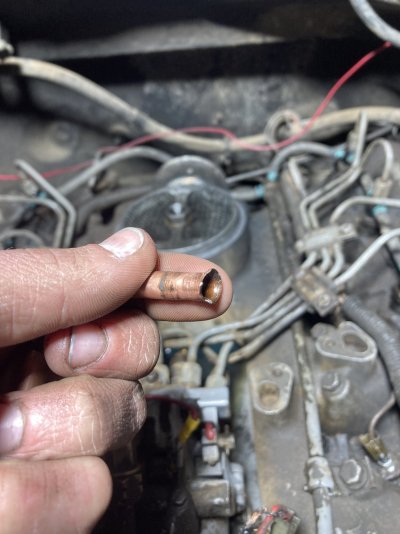

Sorry for the late response. I spent a little time this week looking cleaning the engine and looking for leaks. The majority of the fuel appeared to be coming from the back of the ip where the line comes in from the fuel filter. I took the line off and the flare at the end was half broken off and the olives were definitely not in the best condition. I re flared the end and put new olives on both sides and it stays dry in that area now. I did also find that one of the injector o rings is still leaking and the cap is seated all the way so I’m going to need to get a few more o rings to replace them I think. After that I guess if it’s still having problems I’ll have to go through the entire fuel system and fix anything there if there’s anything. Thanks for the help guys

That looks like a copper line. That should be steel. I’m guessing someone replaced the original with soft copper plumbing line. There are a few guys selling replacements that use hose instead of a steel hard line. I would do that, or bend yourself up a new line using steel. The copper will likely not hold up to the vibration.
Also, did you find the little piece that broke off of the copper? That probably wouldn’t make for a happy IP.

I couldn’t find the broken piece. I’m hoping it fell into the valley under the ip and got lost because I can’t imagine that being good for the pump. I was talking with a guy I know and he said that it was soft copper air conditioning line. I’ll be switching to the rubber hose pretty soon here to avoid more issues. Is there anyway to get that copper out of the ip if it did go in there? Or is it just permanently stuck in there causing havoc? Also just some background info, I have daily driven/repaired early 80s ford trucks since I got my license 2 years ago but I’m new to diesel and I’m new to these online forums as well
