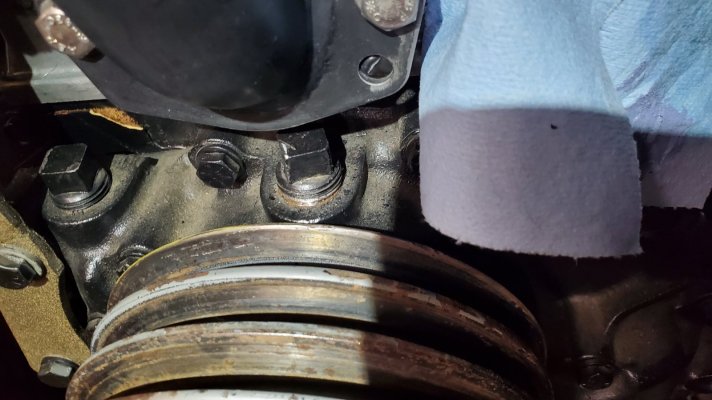

So this location is the spot for the after market water temp probe? Meaning I have to remove this nicely sealed filler neck?

I believe my 7.3 is a lot more accessible than that is.
6.9 . . . I have a 6.9 in my '87 F250. It has the port in the back of the manifold for the 6.9 glow plug temp sensor. The upgrade to the 7.3 relay (I Believe) eliminates the need for that temp sensor in the back of the manifold. Most people unscrew and toss then plug it with a 1/2" (?) Pipe plug.
Do you have that option?
The problem with the water pump is making sure the probe does not hit the internal blades which would make it necessary to add a spacer and you don't have the space for that.

All of these engines have that option. If that head is flipped around and put on the other side, that is the hole for the fast (high) idle temp sensor. The heads weren't built for driver's side or passenger's side (the plugs and senders were all added later, probably after initial engine assembly) so they all have the same ports.

I believe that the one in the block is 3/8" NPT while the ones in the heads and water pump are 1/2" NPT.

The plug in the water pump is water from the bottom of the radiator and it's not an accurate reading of cylinder head temps AKA it's after the thermostat.

So if your running an EGT and the temps go up, it would follow that the cyl head temp has also gone up. My preference is to not have a dead gauge on the dash. If I had another port to plug into other than the water pump, I would tend to go that direction.
Another possibility is to "T" the fitting at the cyl head and run a temp sensor at that location.

You still have another plugged port beneath the valve cover, behind the overtemp light sender, toward the back of the head that you can use. I can perfectly understand the no dead gauge thing. I'm the same way. It doesn't have to be accurate as long as it works.

Yep! Your right. Now to get my Allen wrench in there and see if I can ease it out.
That might have to wait until the engine comes up to temp and now with an uncle's estate to go through, it might be a bit longer.
