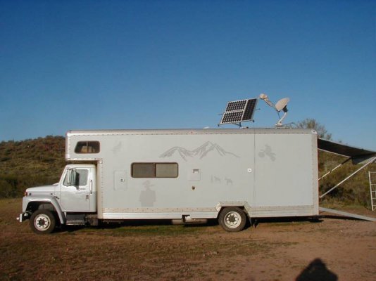

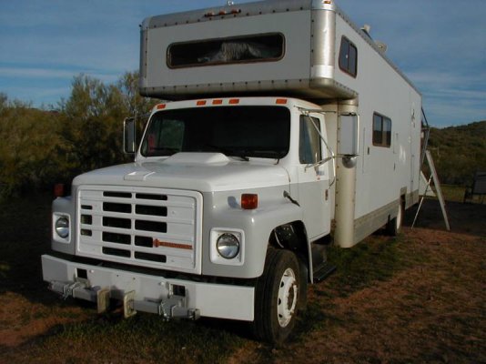

If I had one of those complete, at this point, I'd turn one into a toy hauler/camper.
That's called a FunMover. That's what mine was for 11 years traveling 7 Western states with dirt bikes in the back and an F-150 towed. Not too fast in the mountains!
