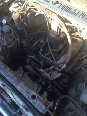

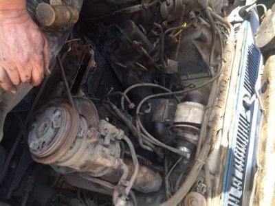

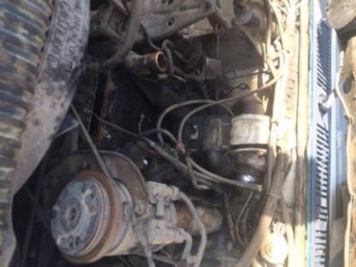

We have been disassembling the engine bay little by little, got a few pictures to share. I had to make a tool to hold the WP pulley bolts while junior pulled on a wrench and breaker bar to bust loose the fan clutch, that is what I am pointing at in one picture.

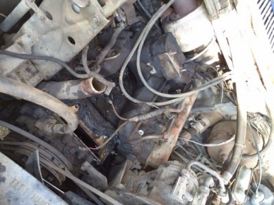

I have never seen a turbo setup like this one, maybe someone could give some insight. It seems to have been modified in L.A somewhere, there was a tag on the air cleaner. The hat resides under an odd shaped filter housing made to house a flat K&N filter. Pics of that later.

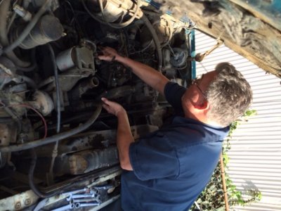

It has been a few years since I took apart my truck and forgot how to remove the IP while telling junior that it was important to leave the housing and gear on the engine (even though we are taking the engine out), just as a guideline. But I forgot to take off the three hold down nuts (actually forgot about them completely) and the IP wouldn't budge. So I told him how to take one apart in the pick-n-pull yard, taking off the housing and all. That is when I remembered the nuts.
Bonus! After soaking them with AeroroKroil for about a week, all 4 of the exhaust side turbo flange bolts came off with little fuss. No galled threads, even.

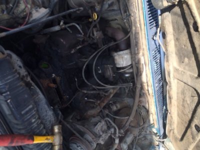

In the lower left hand corner of picture #6, you can see a small fan. That is part of the electric vacuum pump the P.O. installed, apparently because he had one. Secured with bungee and a few tie wraps to the fender well.

Mike thanks for the great pics and no harm or foul for removing the pump with the gear housing either cause your rebuilding the engine. Even forgetting the pump drive bolts is no biggie too. that was really fun going to the airport with you to pick up that rig. I recall filling the bed of that truck with spare tires and wheels and finding the 3/8 drive air wrench in the bed when we got it home too. I think you were as surprised as I was when it came off the tow dolly when we turned too tight leaving the airport drive way too. I know I was even more surprised when the AAA tow truck turned up with a slide off bed picked up the ftont end and got us back up on the tow dolly so easily. It has to have been a magical moment doing that too. Ah memories made that day it sure was.....:thumbsup::thumbsup::thumbsup::angel:
