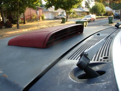

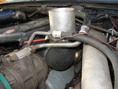

So before the road trip I got this installed, results
100* less EGT cruising all speeds
About 200 less full load on hills. Now to insulate the cold side IC tube.
Cut off the lower end of the elbow to miss the AC lines, the clamp just hits the CDR bracket, little more noise with the windows down , but worth it for cool air.
Ford F600 scoop

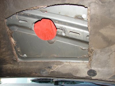

Hey Typ4,
Nice install, but gotta question, can't quite see from the photo's, but how did you mount the air tube?? Can we get a top view looksee picture?
Is there a filter in the can? Or straight air...I couldn't get away with a straight air, too much dust.
I love that hood scoop.
THX

Hey Typ4,
THX
If you look at the last photo you can see the orange stripe of his air filter.
I really like this setup and will most likely be doing this to my rig, thanks for the photos Type4. :thumbsup:

It is a 74 f series, gas or diesel use the same scoop.
The elbow is a 4 inch rubber over the air inlet of the base. it is stiff enough to hold up the riser tube, and I only measured once, from the cowl to center, then the fender to center, closed the hood, marked and cut the hole. Oh and a 4 inch female ABS coupling OD is just right for clearance.
I am going to "flare" the lip up to make sure water stays out.

So these were on the large F-Series that had an actual hood and fenders, like a pickup, rather than a 1 piece "fiberglass" tilt forward doghouse, like on a Class 8 Conventional tractor?
I remember seeing those around...... but don't remember the hood scoop..... could be I was much younger and shorter, and couldn't see the top of the hood...... There was a 70's era "tree service truck" that was just for sale... I bet it had the scoop also.....
greg_a_morton
Dec 25, 2007
712
blossom tx
some trucks had them but not all. Large f500 or bigger. Those seem to bring huge money on ebay and may be the same that the used on super duty Pontiac's back in the day on muscle cars. I have seen them bring nearly $200!
typ4
Dec 24, 2005
9,117
1,399
Newberg,OR
Greg you are correct an all counts, the non HD gassers didnt have them, usually. The truck it came from was an f600 with a HD 330. The other one we scrapped had a LD 330 in it and no scoop
