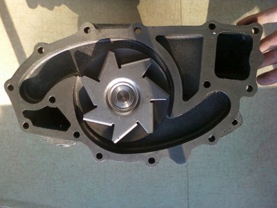

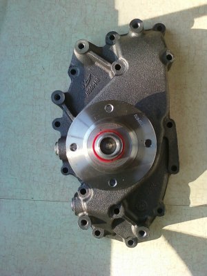

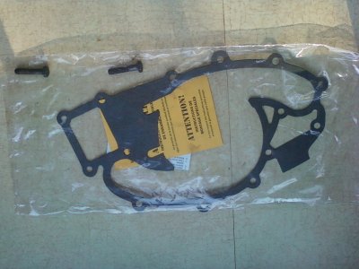

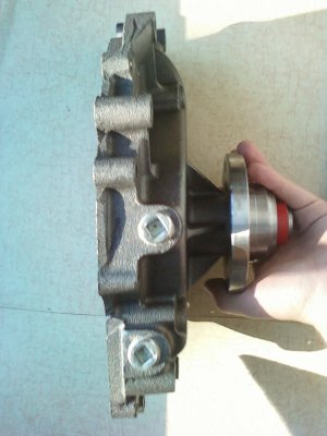

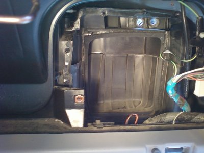

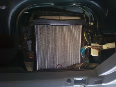

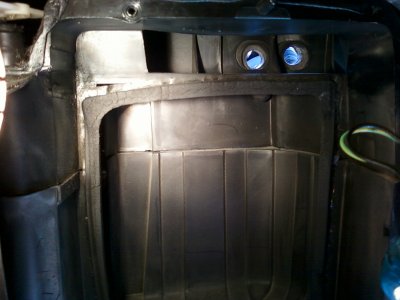

i got my duralast h2o pump from AZ today along with a new heater core. i decided on getting a new heater core b/c my dad was telling my that there was the possibility of flushing it out and then it leaks. so i spent 25 bucks on a new one.
Got heater core put in. went really good.
The bricknose trucks are even easier to do a heater core in. If you haven't its a good time to add a shutoff valve for those hot summer months.
BTW if you search through my old posts, i had issues with the ready rad brand of heater cores from advance. They would leak when the truck was warming up and stop when it was hot. Not 1 but 2 did this. Finally stuck a ford one in there. btw i'd like to see pics of that vatozone pump/

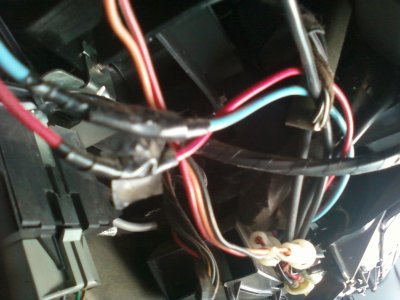

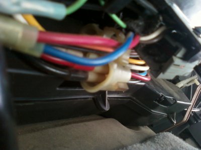

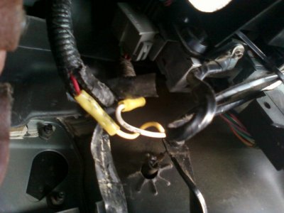

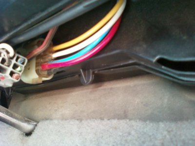

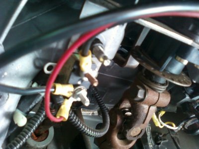

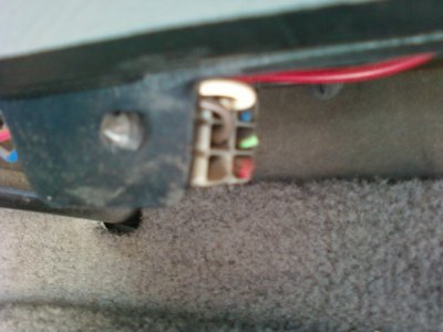

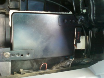

FWIW the last pic on your wiring post is your abs brain, and all the multi colored "wires" are actually vacuum lines to control vents. What problem are you trying to address by showing those pics?
Water pump looks pretty standard, a tip when changing it: pull bolts out of old pump one by one and put in same hole on new one then when old is off put bolts back into old, put new on and pull bolts out of old and put into new then bolt down, this is because they are all different lengths and you don't wanna get them mixed up. Happy wrenching!
