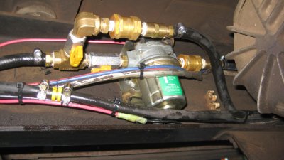

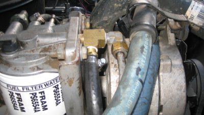

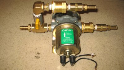

Finally got my electric fuel pump installed.
I ran a Carter fuel pump parallel to the stock lift pump. I put ball valves before each of the pumps and check valves right after giving me the ability to run off of either pump by itself, or use both of them. A few people didn't like the idea due to the additional possibility of fuel leaks, but I'm pretty happy with the fact that it will take some seriously bad luck for me to ever be stuck on the side of the road with a bunk fuel pump. And my truck is starting better because I can purge the air out of the system before cold starts, which masks the leak I have somewhere (I am aware that I band-aided it instead of finding and fixing the actual problem).
First pic is before installation (and before I added the second ball valve), second pic is the whole setup bolted to the frame rail just behind the transfer case, third pic is a couple of fittings I added to the fuel filter head to add the second fuel line.

Nice setup! I really like that idea of having a backup electric pump if the mechanical one goes bad. Also nice to have for purging the system after swapping fuel filters too. Speaking of which, ditch that Fram!!!

I knew somebody was going to give me flack for the Fram filter. Only one I could find at 8:30 on Sunday night......

I have been running parallel electric and mechanical pumps for several years.
To better help understand the principle, here is a description :
Think of the original fuel-line in front of the mechanical lift-pump as if it were a model rail-road track; this line between the fuel-tank selector and lift-pump is the main-line RR-track.
Now,we are gonna install a "passing siding", such that our trains can go around the lift-pump.
To accomplish this passing siding, we install two track-switch-turnouts (TEEs), one ahead of and and one beyond the lift-pump, plus track (fuel-line) that connects these turn-outs.
Of course we install our electric-pump within this passing siding.
Now, our trains (fuel) can take either track (fuel-line), the main-line track through the mechanical lift-pump, or the passing siding through the electric pump.
Now, since we only want our trains (fuel) to take the selected route, and we want to be able to accomplish this from our centralized dispatching center miles away (in the cab), we need to install some block signals (check-valves).
Since it is possible for a diaphragm lift-pump to rupture and pour fuel into the oil, we are gonna need a check-valve on both sides of the mechanical lift-pump; thus, fuel-pressure from the electric-pump cannot be forced backwards through the lift-pump and into the crank-case, nor can the engine oil get sucked through the ruptured diaphragm and burned with the fuel.
To prevent the ruptured lift-pump from pumping fuel into the oil while the electric-pump is running the engine, ONE cut-off valve is gonna be needed immediately ahead of the lift-pump.
The only occasion that would require this cut-off valve be closed is should the diaphragm rupture; all other use of the electric pump can be accomplished from within the cab merely by turning ON or OFF the electric -pump; the check-valves take care of the rest.
Now that we have an electric-pump, we can get fancy and install another TEE fitting, then a cut-off valve, then a female quik-couple.
Make a fuel-hose as long as possibly necessary with the matching male coupling on one end.
I use plain old brass air-line quik-couples and thus far have not had any issues with incompatibility with fuel.
Now, we can connect our hose to the quik-couple, open the valve, turn ON the pump, and pump fuel from the truck and into a sippie-cup, BALL fruit-jar, or D-8 CAT dozer.
This little convenience often becomes handy, besides the :thumbsup: factor when you show it off to envious onlookers. :)
Hey its all good man, just was giving ya a hard time about it. LOL Its at least something until you can get something a bit better. Avoid the NAPA store though...$45 for a filter in my area. :puke:
http://www.fleetfilter.com/mm5/merc...fleetfilter&Product_Code=33617&Category_Code=
I like that price better. ;Sweet
