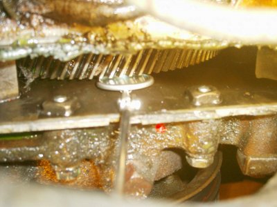

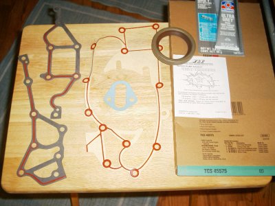

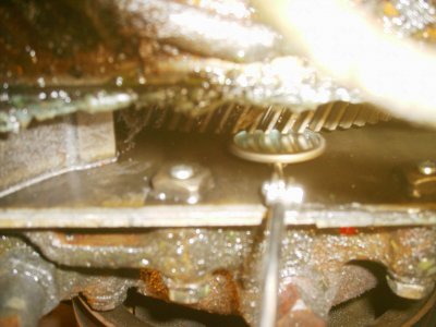

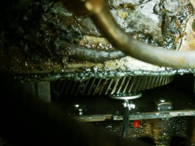

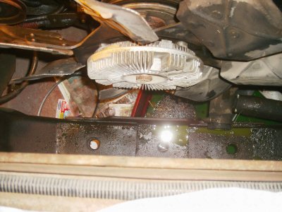

Would a sticky be good about this?, I am ready to expose my two "Y" marks and I think I need to pull the water pump because I followed the You Tube video when pulling my IP pump,...

If you're going to pull the timing gear cover, you will need to pull the water pump first...you'll also need a pulley remover to remove the front crank pulley. Once you have the timing gear cover off, you'll want to get the front crank seal replaced.
It actually isn't a MISERABLE job, but it is time consuming. Since you're going to need to drain the cooling system anyways, pulling the radiator will be beneficial to give you some more space to play with. Maybe this link will help you?

Thanks for the pics... All the pictured gaskets are exactly what you need to remove and instal the front cover. The grey gasket is the mechanical lift fuel pump gasket... you probably wont use that gasket but its nice to have as a spare. Now you seem to be a turning point. Rotate the engine till the timing marks line up on the vibration dampner. TDC is the short hole and you will actually feel a raised line stamped into the timing tab thats welded to the front cover. You do have plenty of room to see the Y timing mark on the cam gear. You may need another mirror placed on top of the gear teeth to reflect the image. Use a flashlite for more lite also. Then count 17 teeth from the injection pump gear up both sides of the gear. Mark that tooth. Do both sides and make a mark across the gear. Now set the gear down in the cover till it "finds" the cam gear. That line you made across it will be parall across the top of the front cover and the two Y marks will be lined up. Push the injection pump gear towards the back of the engine for more room to look in and verify the marks. Use anything you have that shiny and flat... Sometimes a piece of common shim stock is shiny enough to see both of the Y gear marks. Any autoparts has shim stock. They sell it in thicjness from 1 thousands and up. Stainless works well. You need a piece about 6 inches by 1 inch. 3, 4, 5 ,or 6 thousands will work fine. The gap you have between the gear and the front cover will allow plenty of room for this shim stock to reach and see the marks. Hope this helps keeping you from removing the front cover....

I just got off the phone with John (sorry, lost connection...call me tomorrow) and he doesn't have the water pump out yet. Anyone have any pictures of the balancer with the timing marks lined up, so it can demonstrate what we are trying to explain a little better. I sounds like from your explanation Gary that he'll get it nailed. Wish I was closer I'd drive up and help out.
