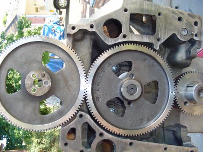

You can see down into the front cover. The cam gear timing mark will show up. A small mirror can find it. remember the cam gear has both a dot and a Y mark on it. You want the Y mark facing up to match the injection pump Gear Y mark. Just drop the injection pump gear down into the front of the engine. Then use the mirror to see the Y timing marks. That will save you plenty of work pulling the front of the engine off. BTW... The oil pan does not need to be loosened for the front cover to be removed but... when you instal that cover use plenty of rtv at the bottom pan to block to cover seal... You have three differant sealing joints in this area... any oil or dirt in this area will result in a major oil leak. I use brakeclean to clean off all oils. It doesn't leave a film. Also the vibration dampner needs to be removed for the front cover to come off... Hope you knew that ....:sly This is what the timing marks look like. The injection pump gear is 17 teeth from the edge of the block down to the Y and the gear can't roll out of the timing when you install it. The gear can roll from side to side but once its lined up it will stay that way when you are installing the top aluminum gear cover. Click on the picture to enlarge the pic... then count off the teeth from side to side. Notice the crank to cam gear timing dot lined up... You don't want that dot facing up to the injection pump gear. If you need more help please ask... Its better asking now than trying to fit a mistake later....
