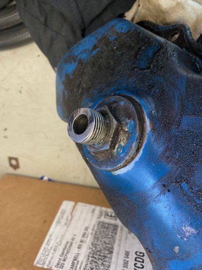

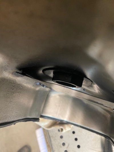

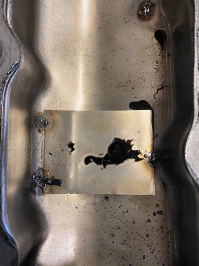

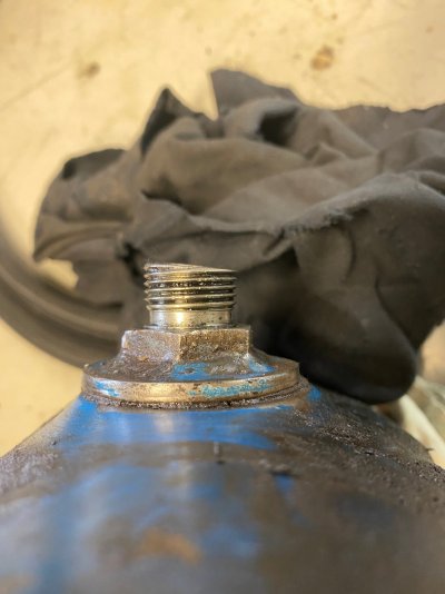

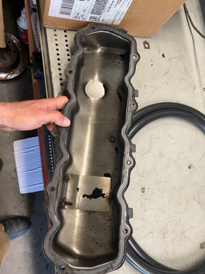

Sorry to revive a dead thread but someone recently asked for info on the valve cover mod I did for the vent hose. Since I'm not running the ATS 088 setup anymore, the old valve cover is no longer in the truck. I can't figure out how to send photos by PM so I'm posting them here instead. I'm not sure if ATS recommended an internal baffle like the one I tack welded in, but I thought it was a good idea at the time. The fitting itself is not pretty but it did the job for many years.
Anyway, hopefully someone finds this useful.

What's funny is I had a customer with a 088 they pulled out of a field, and one of the last things I did to get it road worthy was exactly that
Pretty sure it's the same on too
Everyone on the FB pages were losing their mind that it wasn't Oil rated but I didn't care as a previous unobtainable part now could be replaced

I can confirm it wasn't oil rated but it did the job. And it leaked less than the original vent tube that came with it (even before it ripped).
