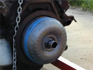

Clarification... The rebuild wasn't $300 - that's what he's asking for the trans. He bought the motor and trans out of a shuttle bus - he only needed the motor. He sent pics of the trans and converter (I'll try to post). The converter and the front pump look BRAND NEW. Can't imagine anyone would put a new front pump in without going through a complete rebuild...???

Problem with the E4DOA is you can burn up one of these trans by going around the block if the solenoids are malfunctioning. a clean front pump is a clear indication that yes someone was there recently and it was to band-aid it together. he's got it priced at core value....high core value that is. I wouldn't buy a used E4DOA for one, but if I did I would want to drive the vehicle first or pay no more than $200 for a rebuildable core and that would be subject to teardown inspection before putting out the $$$.
