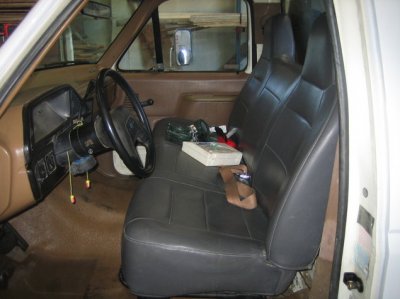

i found the pic of a bench install....
sd bench into a 87-91 body....
note how close to the edge of the floor bump contour the seat mount gets.

If I see what you're talking about, that is the part that I will be fabbing up a new box tube frame for, replacing that mount.
Thanks for the pics! Now I can see how well they fit in there!
