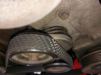

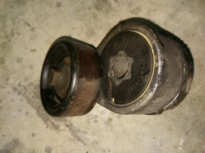

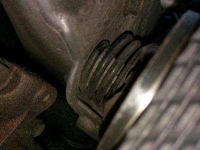

This is on my 1993 Factory Turbo, open spring style, as well as the accessory bracket holding the tensioner

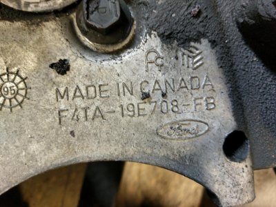

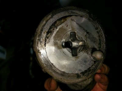

This is from my parts 1994 Factory turbo that i pulled on Friday

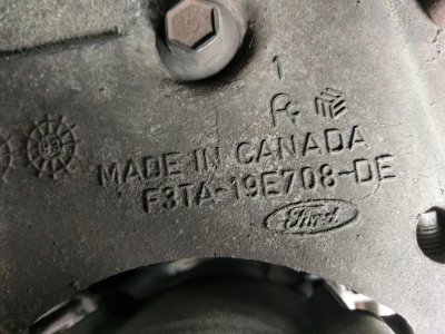

It appears that the accessory brackets have different part numbers
For the search engines
F4TA-19E708-FB - 94 acesssory bracket
F3TA-19E7O8-DE - 93 accessory backet
F4TA-6B209-DB 94 - closed (non visable spring) style tensioner

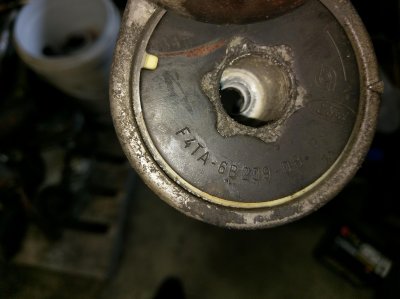

The tensioner on the 93 spit a bearing and the center bolt boss was only barley long enough to locate 1/3 the way into the bearing,, I ended up welding up a bushing for the bolt to gain a full seat.
From this
To this
Fwiw. This kept the bearing from cocking on the idler wheel( ford part) I think?
