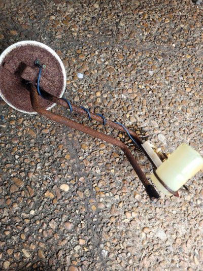

Newish front gas tank. New sending unit 3yrs ago. Changed fuel filter, full of rusty junk. Pulled sending unit, totally rusted! About to pull and clean tank out and get new sending unit ($31 on ebay)
1. Anyone use an alternative screen instead of the prone to break off showerhead in tank filter?
2. What happened?? Maybe bad fuel (always Sams Club) that had water contamination caused all the rust?

This is what's incredible to me, I put this sending unit in 3yrs ago.. look how rusty! The inside of the tank was OK, except for rust off this and (3yr old) showerhead chunks floating around.

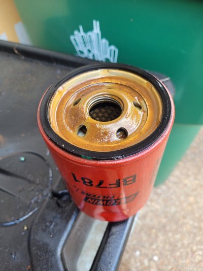

Check out the fuel water filter too. It's after the FSV unfortunately..
When i replaced the senders on the 86 6 yrs back, they were probably original, the top side was as rusty as your under side. There was no rust on the in tank parts. Wonder why yours are so rusty.
Looking at the top of your filter, looks like maybe algee problem? Haven`t seen one like that. and all I have owned since 81 is Diesels.

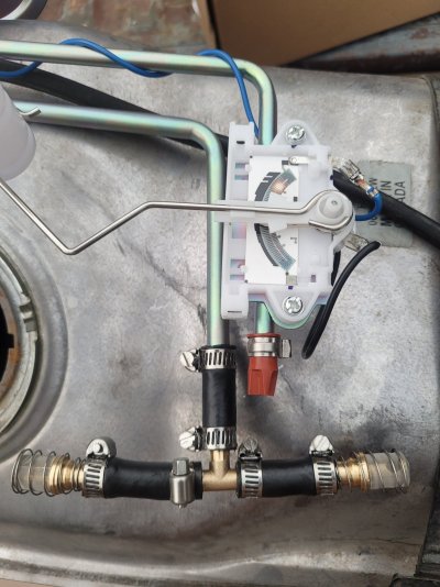

If you can use that filter thing on the pick up tube or install one before the FSV of decent size. Some use a hose on the end to sit on the tank bottom with a "V" cut into it.

Well, here's what I rigged up. Blowing through them they seem like they will flow an adequate amount of volume. That's $30/ft submersible hose and those filters have a very fine mesh screen for whatever little sediment I missed in the tank.
