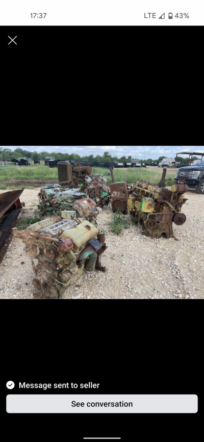

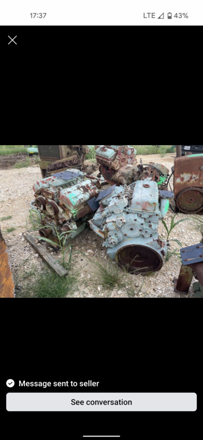

I found some Detroit's south of Austin. Several V6s and Inline 4s. They are block cores and either N/A or the turbo is missing. I get more pictures Monday. If they are 53 series I'll pick them up for rebuild. I think I can get 3 cores for $500.
