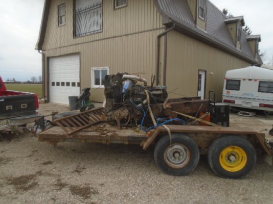

finally found my dt360 this spring and its a beauty. came with lots of extra parts . selling the 3126 now.
