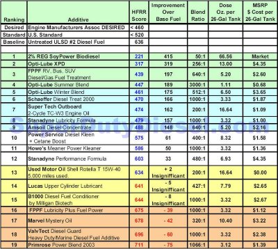

Here's the lubricity ranking chart,testing was done by an individual.

The chart indicates the amount of lubricity properties of each additive/oil/fuel to basic pump Diesel fuel.
Best on the chart 2% BioDiesel bottom of the chart Primrose Power Blend.
I would stay within the Top 9 on the chart personally.
The testing was done only for lubricity.

Is there a negative side to 2 cycle oil? From the chart motor oil has the same lubricity as diesel fuel.

I was surprised used motor oil ranked so low. I was also surprised to see that some of the more common players were not listed on the chart, such as Howes Diesel Treat, and common ATF. I'd like to know more about how the tests were conducted, and I'd also like to see the findings verified. Anybody can throw an authoritative looking chart out on the internet and have people think it is gospel. Nice chart, and nice info though... if it's accurate and true. The problem with most of those additives is they do nothing for anti-gel, and anti-bacteria growth. A true fuel treatment adds more value than lubricity alone, so the cost per gallon may go way up if you're fuel system gunks up on you because you skimped on protection.
