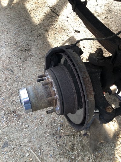

I’ll get bearings order today. One more question I had is the hub supposed to be inside the rotor or on the outside of the rotor? I had to punch the lug nuts out of the rotor and the wheel hub was on the outside face of the rotor..here is a photo. I’m thinking someone messed with it to make it wider?
But if I changed it maybe the brake rotor wouldn’t line up with the caliper mount?

That looks right to me. I’ve done them on these axles before. Just did one on Saturday, actually… Not difficult. Just make damn sure everything is clean, and you’ll be fine.
