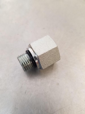

Something like this puppy?

Thanks...looks like you might have got the last one... I now know how to ask for it.
You had the same thought I did. Leaks at the swivel. I am going to hose barbs anyway.
Glad I hadn't bought one yet...I don't think the one I found is the right one...maybe this one.
Thanks!

If you want to do this on your own, do yourself a favor and go -5 male ORB to -6 JIC male, then make your turn and hose connection with a corresponding hose fitting with a female swivel nut. Part number should be a 6-5 F5OX-S (I only speak Parker adapters).
