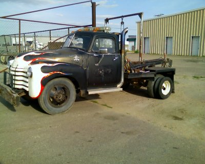

Made the first roadtrip, last weekend. Valley Rods Unlimited 34th Father's Day Rod Run.
Hays, to Osborne, to Ord NE, and back. 3000rpm@60mph, 256 miles, each way. I CANNOT wait to get the 350/700r4 installed.
It was A Lot of work, just for a couple good hangovers. Also won a Budweiser beer bucket, and a Bud Light folding grill, in the doorprize drawings. Not a total loss, as it turns out.
The old 250 6-shooter ruled the flamethrowing, as usual. The stacks went from chrome, to blue, to orange, back to blue. I never liked chrome, anyhow.
Finally remembered to download some refit pics from my phone, too.

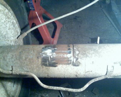

Had to move the perches out 1" on each side.
Yes, that's the stock leaf stack!
Those are temporary fender extensions, until I get the bedsides ready.
Next is the big jump! Front suspension, hydra-boost, 350/700r4. All or none, I'm afraid.
