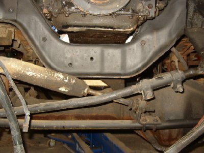

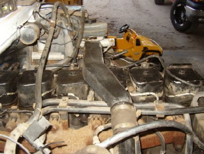

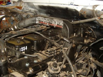

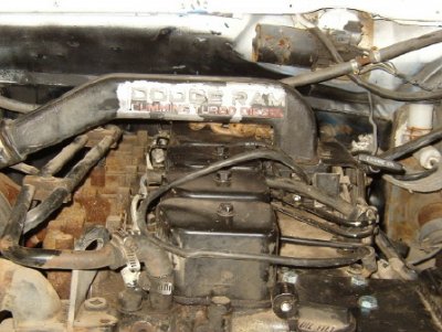

started the swap yesterday (finally).
Motor is in and adapter,flywheel and clutch are on. Just need to bolt up the tranny and t-case, then comes the fun stuff. Driveshafts, put the front clip back on, bolt on bed etc...
Here are a couple pics so far.

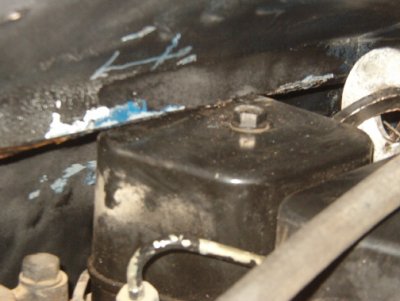

The biggest issue I see with the exhaust is that the starter is directly under the turbo on the passenger side. Without a body lift there is no room to go between the starter and the firewall. It looks to me that you need to bend a downtube in an S shape to go in front and then under the starter (kind of hard to explain).
1. you could figure out the install without the brochure, but I bought one anyway. It does have some helpful hints. If you havent called these guys yet you should, they are very helpful with what you need and don't need. Open up your wallet real wide though. I've got close to 1800$ worth of stuff from them sitting in my rig right now.
2. brochure covers pretty much everything. Not to many pictures and some stuff is kinda vague.
3. So far the lift is not needed. I have the motor and transmission in and it does not seem to hit anywhere. The lift would make it much easier to get in but doesn't seem necessary at this point.

I don't want a body lift on it. I can make it work without one, just gonna have to make my own exhaust. I've got the exhaust from the truck it came out of, just need to cut and turn the down pipe so it will fit. I just talked to a guy last night who did it without a body lift and he made it work so I know it's not impossible.
