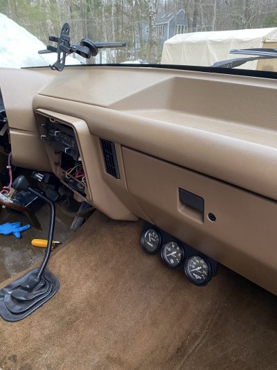

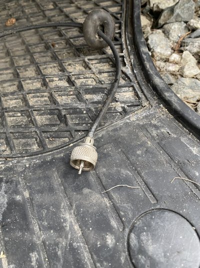

So I ran into something else odd when pulling the speedo cable out. There was another wire going through the same rubber grommet in the floor. I followed it up under the carpet, over the hump, and found this end just sitting there under the passenger carpet.
There are gauges just above there that someone installed. But this wasn't connected to anything. Just sitting under the carpet doing nothing.
I traced it the other way through the driver's floor and under the cab and it disappears up into a plastic conduit with other wires and goes up in front of the firewall and that all looks to be OEM.
What the heck is this cable?
