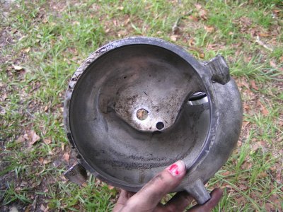

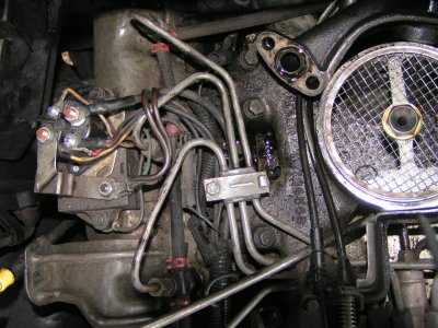

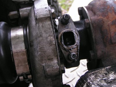

Ok..... So, I went on the venture to get the intake snail off and couldn't get a bolt off of the air cleaner box thing, so I got my roommate to come out and help me and one thing led to another and he was bound and determined to get the turbo off, so off it came.... in about an hour...... without too much difficulty really. I took some pics of the turbo off the truck, there is a puddle of oil under the turbo, not and ridiculous amount of oil in the snail or on the exhaust side of the turbo either.... We're at a total loss as to what is up with this truck. Now, the only other suggestions he (roommate) gave me was there is a little oil on/around the rear main seal area, nothing excessive, but could that thing have blown allowing oil into the tranny? :dunno Without dumping tons of oil on the ground? Now that I have the turbo off, what should I do? If its good just stick it back on? Is there something simple that can be upgraded to make it better? I'll post the pics. Thanks a bunch to ya guys! :hail
hmmmm.... well you could start by sending me the whole turbo system, it must be no good at all i'll get rid of it for you:D :D honestly don't see anything out of wack there. so it hasn't ever left a big puddle? sounds funny:dunno if the main was the culprit the underside of the truck would be coated and would leave a series of puddles everywhere it went

No big puddles of oil anywhere ever. Even as it it sits right now there's not oil coming out of, if you run your finger along there you get oil on them but to me nothing excessive and it doesn't even drip........

Guys.. I'm concerned with the butter looking goo all around the turbo drain back flange. It looks really thick.... The CDR valve would be my best guess at this point but.... While the turbo is off rebuild it. That much oil loss is going to show up somewhere.... Tail pipe, ground or its the oil gnomes all over again. They only come when you aren't looking.... Nobody has ever seen one and nobody could pick one out of a lineup....:D After all that, I'm happey you got this apart. It shows that you can do it. You and Tanya are true IDI hands on owners. Glad to have you onboard here....:thumbsup:
