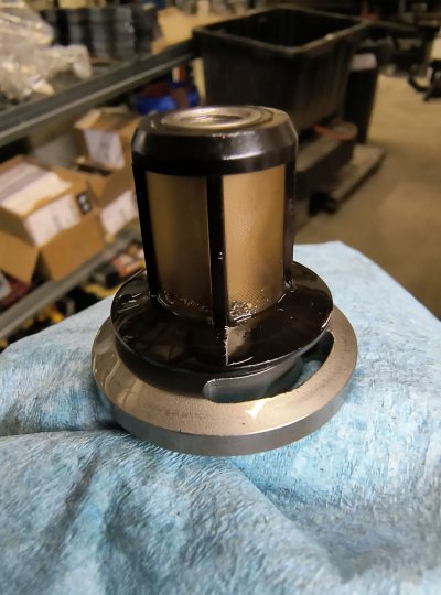

Authorized shops are supposed to adhere to the calibration charts. and have much larger overhead.
And "turning up" the pump after the install will void the warranty, they say not but if there is a problem,,, they default to, "you modified it". Sorry
I know firsthand that the shop that used to do my pumps charged list or more for parts.
They would clean and test /reset injectors. Yes its a rebuild, no you didnt get new nozzles.
If ANY shop opens up a pump and finds contaminate/dirty fuel , or metal particles,, no warranty, but then this is definitely valid .
See pic.
This customer demanded a refund after 8 months of no contact after I offered to refund if he sent the pump back in June.
The metering valve was extremely stiff from debris. Its now cleaned and ran on the stand and hes getting it back. He will be angry about no refund but,,,,,
