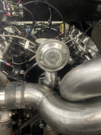

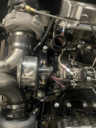

ive ran these things in the stock location, but cant really do that on my new build.
i didnt want to drill into my valve covers, so i decided to get a IP gear cover oil fill, and slap a CDR on the top.
2 8 AN bungs that will eventually go to my air intake tubes.

This was version one which I threw in the trash. I did some scribbling and wasn’t happy with the size of my initial lines to potential pressure.

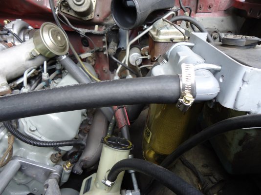

I used a Goldenrod filter as a catch can. I used the stainless mesh in place of a paper filter and added a stainless pot scrubber around the mesh. I'' hose from oil fill adapter and CDR into intake. My ring seal got progressively worse and blow by was filling the catch can, so in a sense it was working. The project is torn down now and on pause due to lack of parts and record cold and snow.
