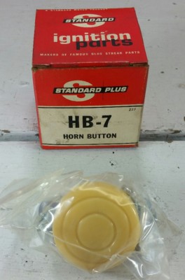

This is what I use...had it left over from the 1980's...
I had a van that the alternator would not charge unless I 'tickled' it...and bought a spare in case I torched the first one...
mounted this on the dash of my current truck and bathe in the memories of driving that van and being...'The Transmission Man in the Van'...
Works good for my glow plugs...less amperage flowing though it...should last for a good while...
This will work better for you...it is truly 'momentary'....

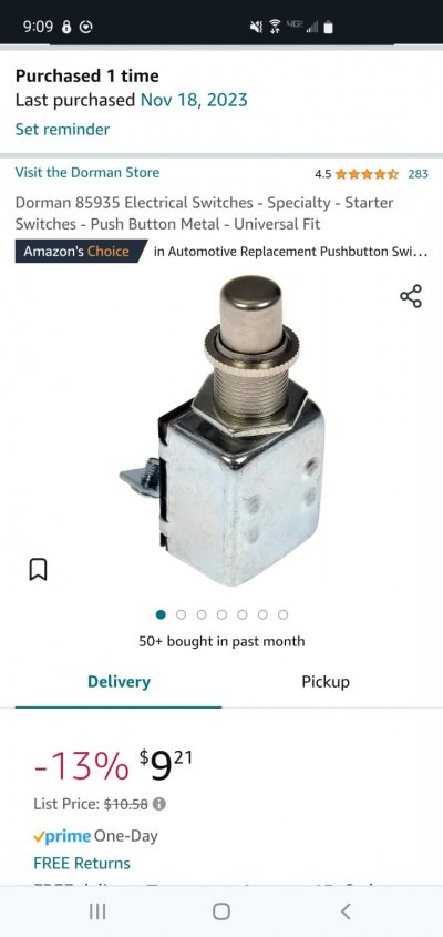

This is what I use, I use the same type to start the truck also. I have a toggle switch for the run position and the key only unlocks the steering.
1,707
1,702
Both of mine have a push button, but I have seen spring loaded momentary toggle style also.
