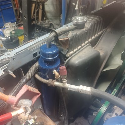

13,325
3,898
IIRC 30 dollar e-bay buy

I ordered the same one as IDIoit, just haven’t installed it yet. Mine just dumps to the ground currently.
