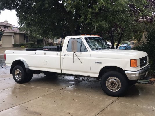

With that long wheel base was this truck a wrecker or some kind of utility truck?
2,494
2,557
I just now noticed it's got a super extendo bed on it with 3 tank doors... Kinda neat. Wonder what the purpose was.
We have two. Yes my son’s is the custom super duty. It has the set up for 5th wheel, hydraulic hook ups and air for hauling big trailers. Someone welded two beds and did the conversion. No sure what it would’ve looked like originally. The one that I’m having trouble with the blue smoke is the red truck. His is a 90 and mines an 88.
