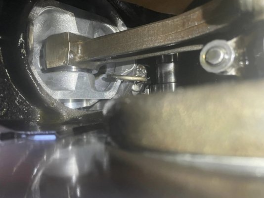

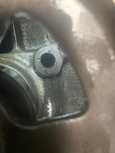

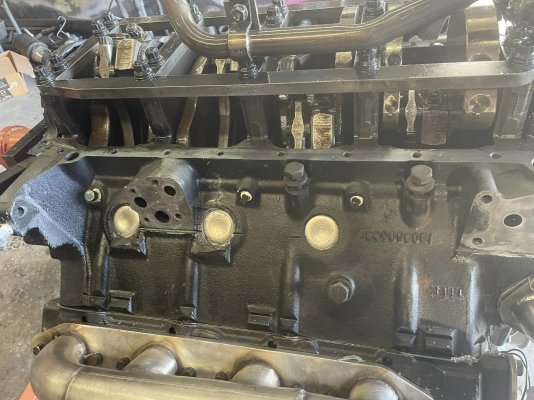

please make sure you check all the plugs in the oil galleys NUMERO UNO!
I just spent the last few days fighting 3 plugs that i just didnt catch.
1 of them was in the oil cooler front header.
2 others were behind the cam gear, for the front cam oil galley.
furthermore,
there are 3 plugs in the rear, and 2 behind the oil cooler tube.
and another one driver lower front, behind the cam gear cover.
and if your squirters arnt installed, you wont have oil pressure :cheers:
