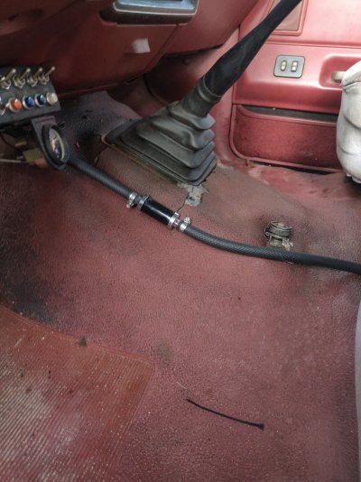

What type of clear tubing to use for this purpose? And what's the best pace to have a permanent one to keep an eye on what's going through?
3,353
3,811
This is what I did in My tow truck. If you look at my thread "Jesus Freaks WMO thread" there's a picture of how I have a glass filter under the hood of my dually. There's no filter it's literally just for watching my fuel for air or anything weird......... because I run all sorts of stuff in my trucks, it's important to watch it.
