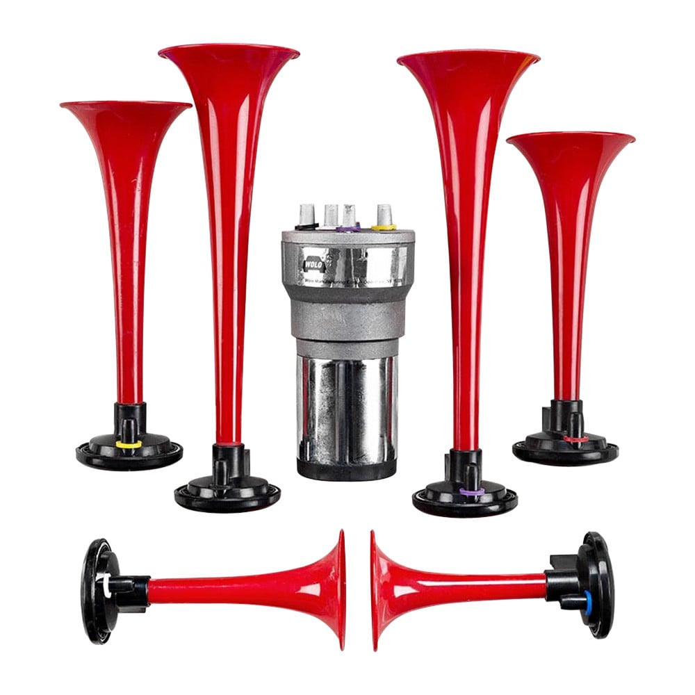

Another option, especially on taking off on an incline is to just not stop. Get an incredibly loud horn and some flashing red or blue lights and just go. I see guys do it all the time and, I guess out of concern for our lives, me and everyone else just stops and let's them go by. It works for them, I'm sure you'll be fine.
I think just having the horns off the general lee, would be enough to solidify the I dont give a ....
