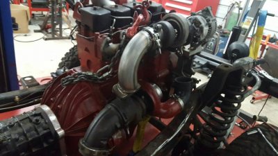

Here is a look at my current project

Nice work! Got a 6.9 to put in my CJ-7 when I get around to it.

Kind of the direction I am headed but not totally satisfied yet

Looks good bud! I've got a compounded 4bt in my Tahoe which is my daily driver. Love it.
Is that an HX27 on the manifold or a 30?
I'm running a 30/35 setup and couldnt be happier with how it performs.
The top turbo is a he221, 6cm exhaust housing. We are gonna see how it does with a he341 under it and a he351ve later on
